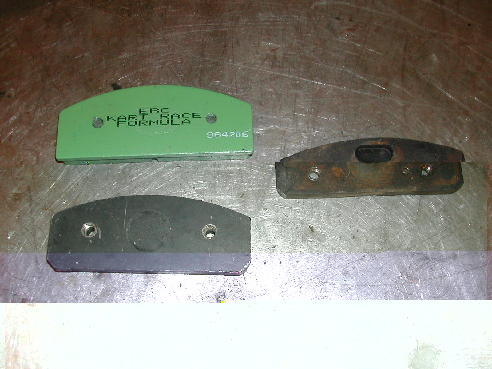

Some fettling is needed. Here are the pads, they are off a Zip cadet mechanical disc brake.
The hole centres are the same but the pads are bigger and thicker.

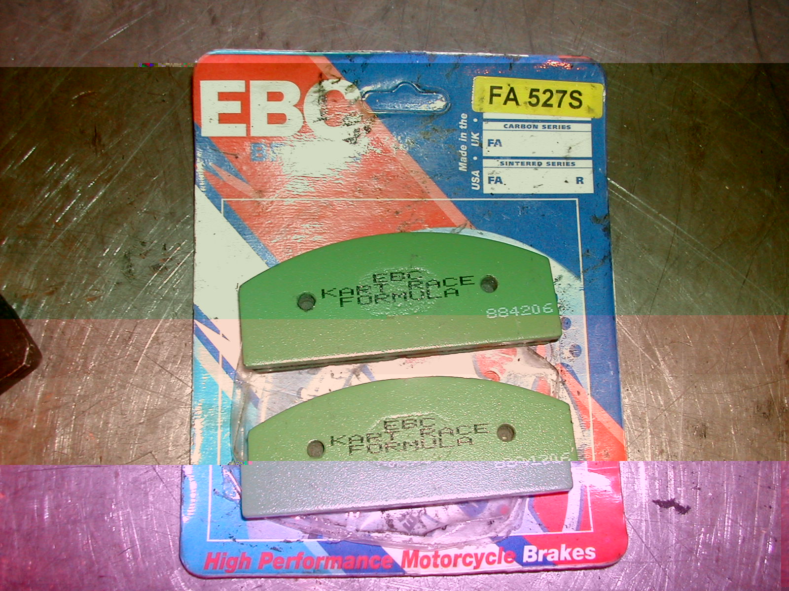

The smaller pad is the original. The green pad is a new EBC pad and the black one is a used one i picked up for £2 a pair.

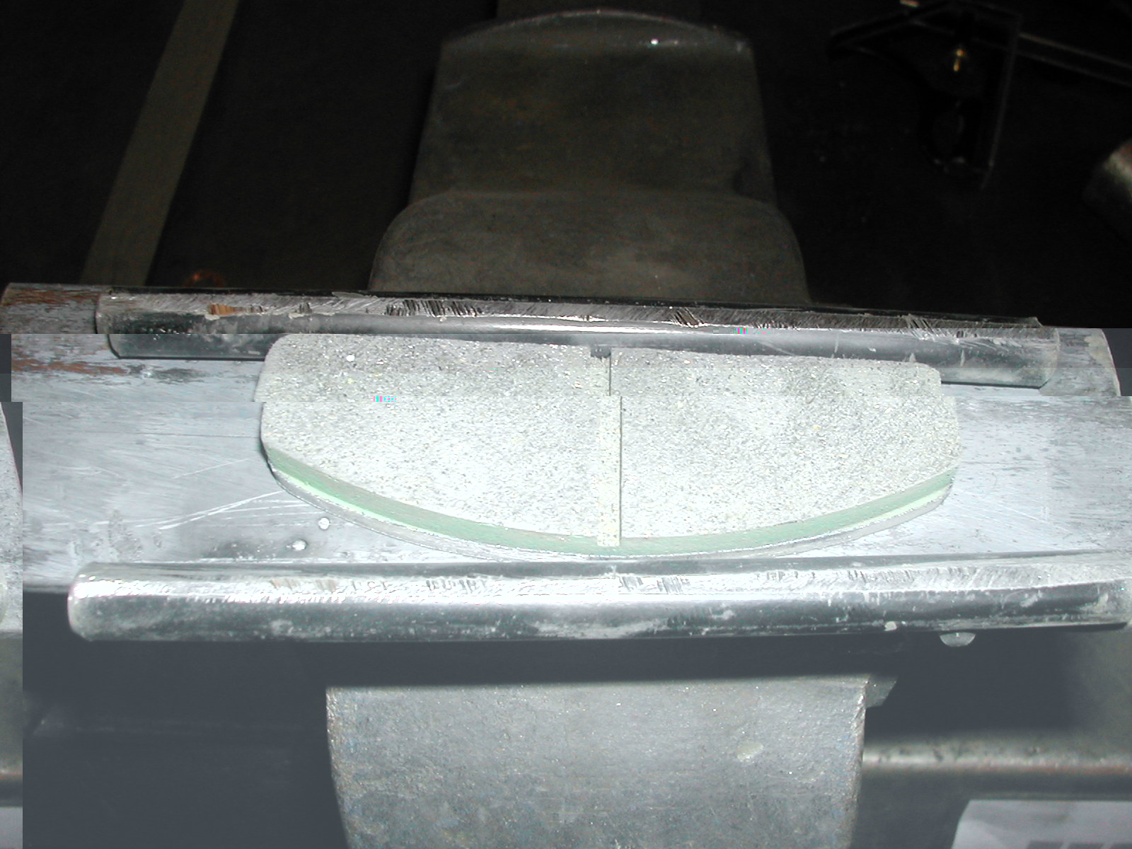

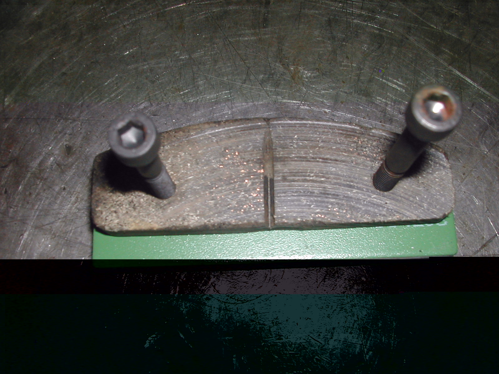

I then bolted the the original pad to the new ones and scribed round them. Then cut the new pads to shape with a hacksaw and grinder.
Then i just needed to shave them down to the right thickness. As my discs are quite thin i needed to get the thickness down to 10mm from 12mm. For this i made a quick jig that the pads bolt down to and two 10mm guides so i can get the pads nice and even.
I roughed them down with an angle grinder and finished them off with a file.
The dust is quite harmful so wear goggles and a dust mask.
Quickly deburr them and you have a new set of pads.

The new pads retail at £13 a pair from EBC and £35+vat a pair from spellfame. Bit of a no brainer that one.
EBC ref number FA 527S for the green pads and FA 527 for the red. Have no idea which is the better compound.

Good stuff! Generally greenstuff green pads are a soft compound, and the reds are hard
