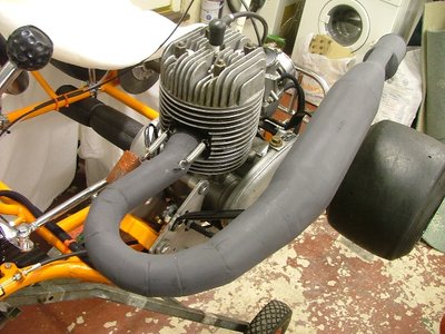

The exhaust on my Villiers has seen better days and could do with a good blast and coating.
It has a hard 'enamel' on it at present and a lot of surface rust.
Once blasted, any ideas for a coating please?

I'm saying nothing, axle looks great.....................................

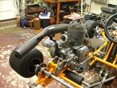

You are dead right. Guess what i used last weekend!
