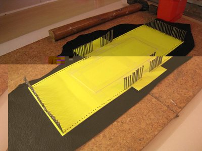

In terms of the leather due to the skin I ordered I found the in logical way was to make to wheel up in three pieces and in terms of the design of wheel I had I wanted it to partly cover the spokes. There are various ways to punch and cut the leather however I went for the idea of making a simple template on my PC to the correct shape and contain all the holes on. My reason for this was I decided to use panel pins to punch the holes and also by leaving the pins in place everything would be held down for cutting the shape out. I also used a cork lined board as a work surface. One major factor I found with all of this is when deciding on what length leather you need is to work on the internal circumference of the wheel. This means that the leather then has the stretch over the wheel hence is not baggy and when stitching it doesn’t bunch up on the internal circumference.

Template on cork Board

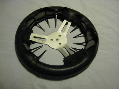

Cable ties holding scrim in place and make it easier to move the leather on to the wheel

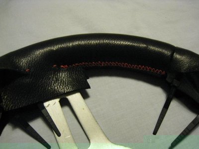

First 1/6 done
First 1/6 done

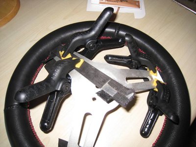

Glueing leather in place around the spokes

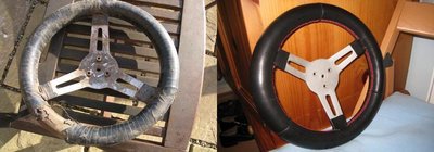

Steering Wheel Before After Comparision

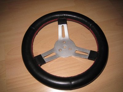

Finished steering Wheel
